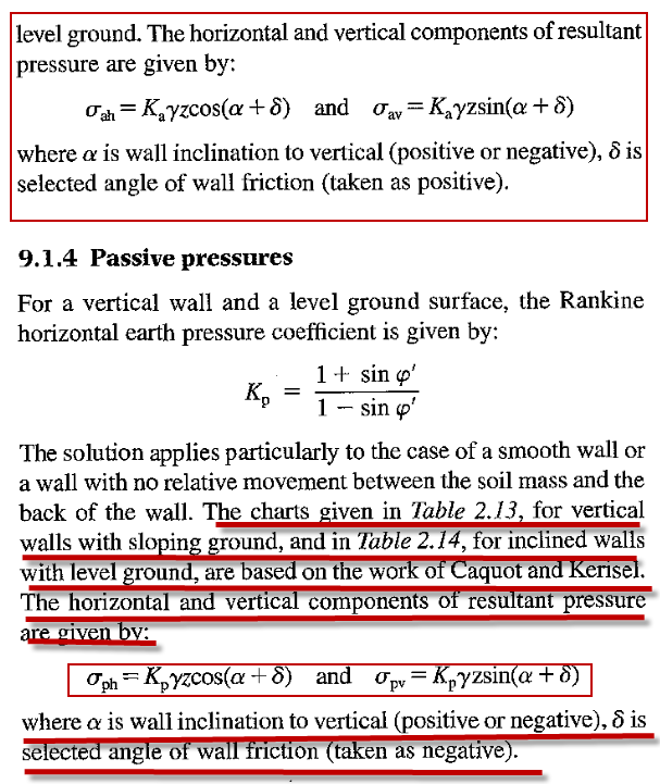

Dear jammer! The angle theta you are talking about is the angle of bank of the backfill with the horizontal. But the question Waqar asked is about the angle of the face of the wall...such that there is additional wedge of soil
Waqar, If the wall is inclined towards backfill, then there is passive earthpressure If wall is moving away from backfill then its called Active earthpressure. There are many theories...to calculate it...most famous are the one mentioned above by Baz
You have to keep in mind about the notation of different angles
Phi is the angle of internal friction of backfill....Tanget of which is the angle of repose of that material (approx.) angle of repose is the angle by which that material is retained..in stable form..
Delta (or theta according to jammer) is the angle of backfill bank with horizontal
Many books and authors use sometimes different notations for each angle..so be careful
Now i would recommend you a book called REINFORCED CONCRETE DESIGN 11th edition by REYNOLD
Read its chapter about RETAINED MATERIAL...for you i have attached the snapshots for calculating the active and passive pressure
