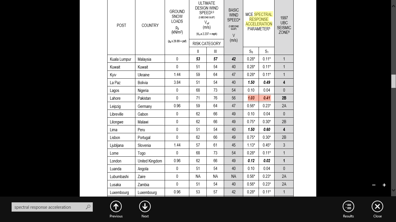

  On 3/20/2018 at 1:09 PM, Fatima Khalid said:
Well I have found the relevant document. Following is the link for the required document:
https://de.usembassy.gov/wp-content/uploads/sites/21/2016/08/Attachment-J.2-2015_OBO_Building_Code1.pdf
Expand
This document helped in finding Ss and S1 for Lahore, as are Ss=1.03 and S1=0.41.
