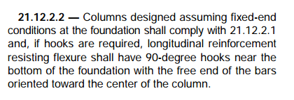

you have to bend bars inside as per ACI code, if you are performing computerized analysis by considering fixed supports.
Bending inside would provide more confinement, improving ductility of joint. Outside is more what construction site guys are used to do. I don,t know why they like it that way.
Our construction workers are generally ignorant of structural requirements. Moreover, they are commonly paid on per job basis, rather than per day basis. As such, they are most probably guided by ways or procedures which may help the job complete in lesser time.
Placing the bottom hooks of column vertical bars to the outer side (opposite to what is required by ACI 21.12.2.2), makes the column reinforcement assembly more stable WITHOUT many lateral supports, as compared to the situation when the bends are turned inwards. This might be the reason why the construction workers keep the column bends outwards in our country commonly.

Umer that is the basic problem which i face while supervising my projects, contractors are always adamant to use it other way, the reason is probably as Ayesha said ,sometimes drawings of very experienced contractor show the bents away from center line of columns. So contractors make it habbit. otherwise on site there is no problem in bending bars towards center line.

So do you think there is some exclusion for the given ACI Code (
) clause?
Codes are written by Committee of Engineers and Professors of Structural Engineering - I know, because I have been involved.
Then codes are then updated every 3-5 years, based on feedback and Engineers' experiences in the filed. So make sure you have the "latest" current and not out-of-date code version that you are working.
The codes are then interpreted by Engineers based on their practical knowledge and experience. For example the UK Reinforcement detailing Manual is to be revised / published in December 2020 to EC2 detailing rules. I am part of the committee for this publication and we have sat in Committee meetings arguing our own interpretation of the code to derive a consensus on detail. All our L-shaped starter bars bend out!
Pakistan does not such  a "Engineers' Committee Structure" to provide guidance to young Engineers as far as I know Sepakistan is only such platform - well done to those who set it up!
1. Codes are interpreted by Engineers. Codes provide guidance only. You need to understand the internal tension, compression and shear stresses of the node you are designing and detailing - and then interpret the code to suit these to ensure the assumptions are achieved practically in the field too!
2. To put your mind at rest, you could use U-bars for columns starters to meet your interpretations of bending inwards (provided anchorage rules are satisfied), and then add smaller additional L-bars pointing outwards on the outside to keep the column starters square and upright.
(We started writing a detailing manual for Pakistan and this is delayed as too much work on at present)
I like your keenness to learn. Knowledge and experience make a good engineer.

Yes you are right. The more we argue about the implementation about the code, the more we get the idea of how it works and where.
