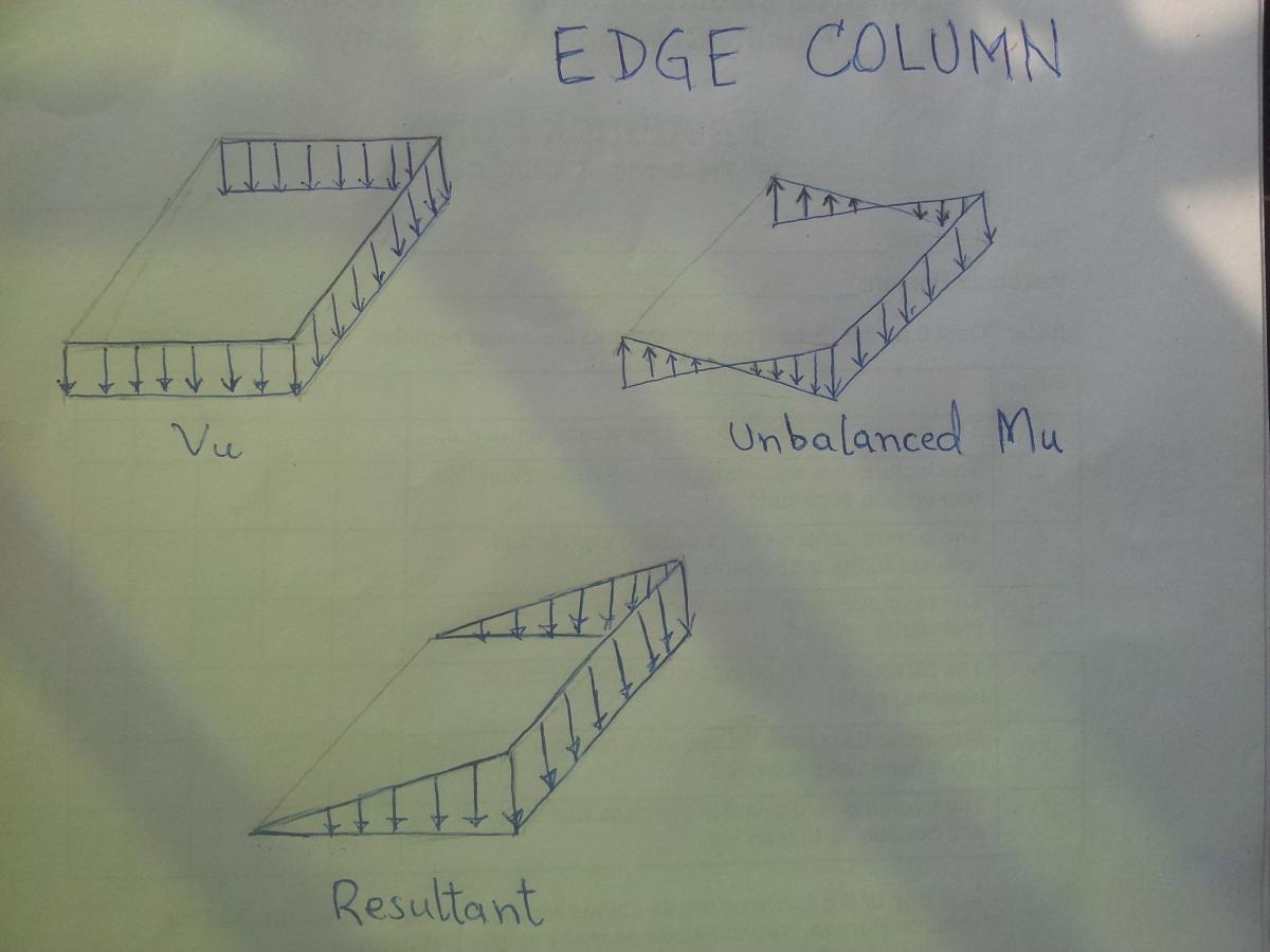

What would be the assumed distribution of punching shear stress due to the transferred moment in flat slab in case of side and corner columns?
Refer to the attached file in case of center column.
Thank you very much indeed.
