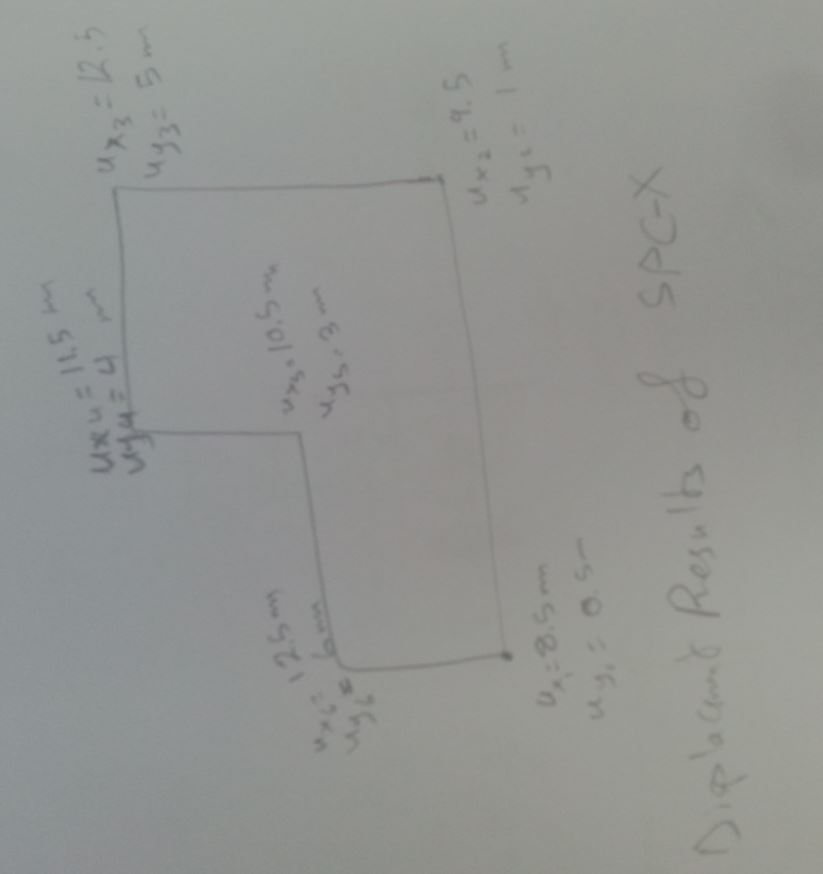

From the figure that you have provided, you can check if torsional irregularity exist at certain level. The torsional irregularity exists when the maximum story drift at a corner including accidental torsion, is more than 1.2 times the average of the drifts at the corresponding corners.
Accidental torsion is related to the minimum eccentricity between center of mass and center rigidity that must be considered at each level.

I know that you have mentioned. But what I need Sir is how from ETABS we can find if we have to increase the accidental torsion by Ax as UBC-code says, or not.
Some one told me :
1. Go to Tables ...Result-----> Displacements -----> Story Max/average displacement -----> ratio values.
2. Those values are if >1.2 then we have to increase the accidental torsion as UBC-code says.
please tell me if that okay or not.
and if yes at any combination shall I work

If there are architectural restrictions, go back and discuss with the architect and ask him/her to modify plans to meet your needs. This may or may not work. Generally speaking, You should be able to remove the irregularity without going back to architect. Share your architectural plan and we can suggest something as well.
