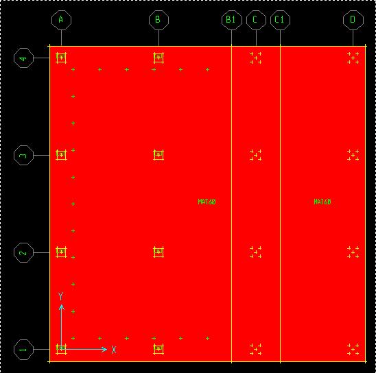

Drop In Mat Foundation
mhdhamood
Mhdhamood,
The situation is quiet common. You can thicken up portions of mat where required. Detailing that I have seen provided a 45 degree angle where the transition is happening, but nothing is stopping you to provide what you drew. Make sure your analytical model represents what you plan to provide and all possible limit states are checked.
I agree with Umar.
Normally, we provide a uniform minimum thickness of mat everywhere, except under columns carrying heavier loads, and requiring larger mat thickness due to punching shear requirements.
Moreover, You may model you mat in SAFE (and possibly in other foundation design software as well), providing different mat thicknesses at desired locations.
Mohammad,
Width or extent of this thicker area will generally depend upon the following:
a. Punching shear value. Width of thicker area in this case may be less than standard width of column strip in the relevant direction. For discussion regarding slab or mat strips, you may refer to the following thread:
http://www.sepakistan.com/topic/1642-slab-design/
b. Site requirement e.g., sloping area where mat is to be provided at two different levels.
