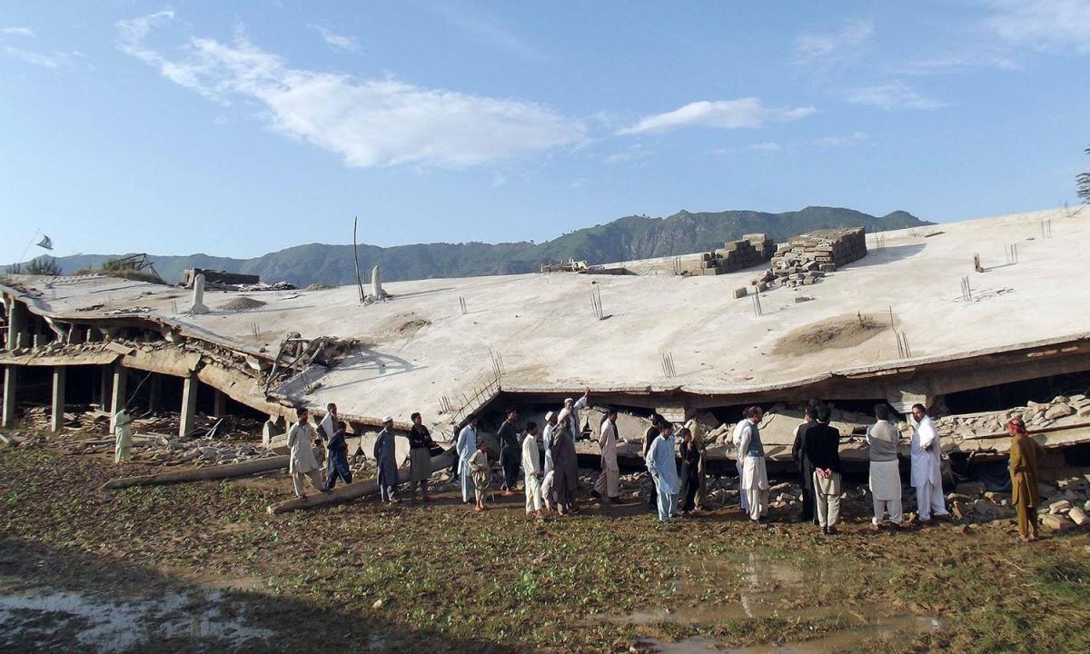

Its extremely heart wrenching to see another 7.5 earthquake and subsequent destruction. As engineers our commitment to public safety stays paramount. Let share pictures of structures that have failed in the subject earthquake and discuss the possible reasons why that happened and how could it be avoided. Prayers for the families who have lost their beloved.
The only thing that stands between an earthquake and public safety is a structural engineer. We need to empower our engineers with the skills and tools that allow them to design ductile systems. For that reason, I request everyone to please encourage other to be a part of SEFP and be more active. It is the only structural engineering platform for Pakistan and Pakistanis. Lets get the best out of us.

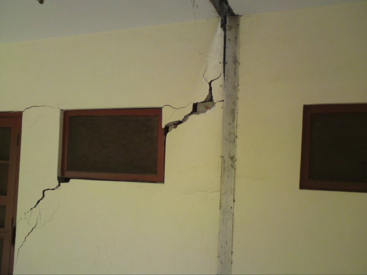

I would like to share with you guys some snaps of a building of arch.dept hostel. The subject building was constructed in 1997 and just after construction, severe cracks started propagating and made it unusable. The site selected for constructed have 35 ft fill organic material and it used to be a dump site of old Lahore.
this is just to highlight the importance of geotechnical investigation and effect of differential setttlement on a small structure.
