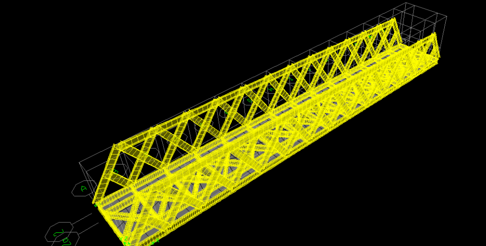

I have been given an assignment to design a cantilever steel truss bridge of 35 meter span. I have analyzed the model in SAP 2000.  I am bit confused and want to know the basic transferring mechanism of forces in such structure.Point that is pinching in my head is that: " TRUSS members only transfer axial forces at joints,no moment." then how a cantilever truss bridge will transfer bending forces  to its foundation ??
how fixed support will act in such case?
How members of truss will transfer their deflection and bending phenomena to supports?

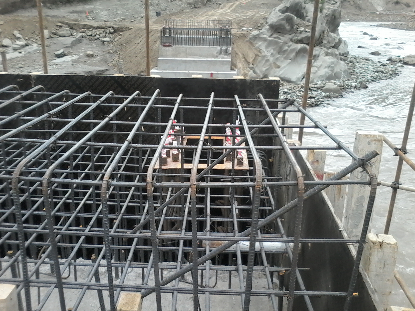

This truss bridge will be rested on side abutments.....
However, the bride is no more cantilever as they abandoed this idea. Still I'm very much thakful for above replies to this topic and want to know answer of my basic question.
