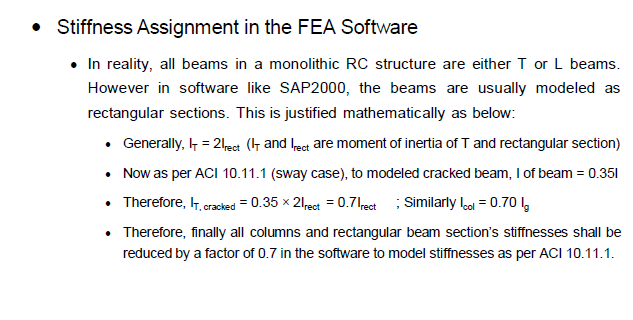

I want to ask if we should give modifier for sections like shear walls, columns, ....etc or leaving as it is ,please I want some explanation about this because I have two high rise building and I need some information about them and if I assume my slab as a rigid diaphragm this affect on it or not
