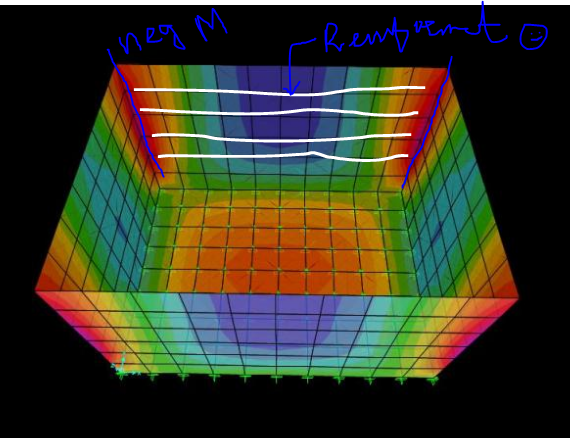

The Best way you can quickly pick it look towards the Negative moment   on support always provide Reinforcement perpendicular to the support for which negative moment is shown ,,

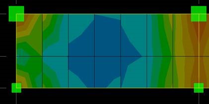

Oh alright. thanks all... so the easy thing would be to go perpendicular to the direction of contours. And if still confused, turn on the local axes. i knew it somewhere but what confused me was a model with one-way ( 32ft*12ft ) slab showing higher or same moment values for longer direction, however main r/f in a one-way slab is placed along shorter direction. So I guess its better to design slabs manually.
One way slab only acts one way if you have stiff beams (a rule of thumb would be depth at least 3 times depth of slab) all around it.
If you don't have beams and a slab is  32ft*12ft directly supported on four columns, your main bending would be along the length of slab.
