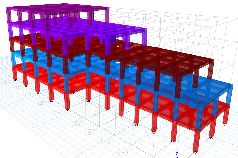

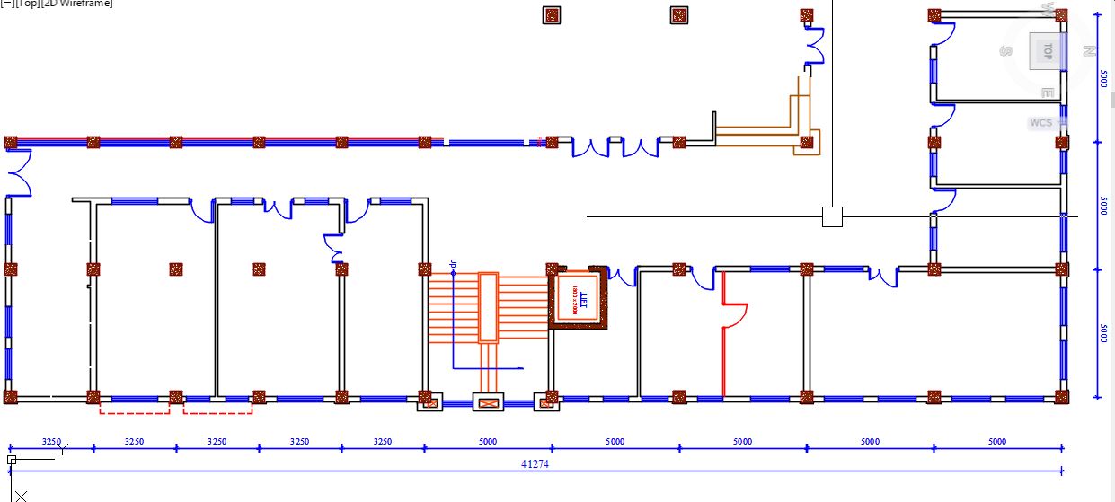

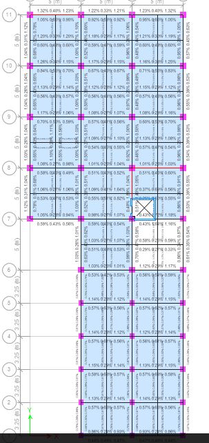

I tried designing a L shaped building(attached imaged) but it has torsional irregularity. How to counteract for that? Details of my material property and sizes are below. The beams(5m span) kept failing how can I design it.
Material: M20 concrete, Fe500 Rebar
Size: Column 500mm*500mm, Beam 500mm*400mm, slab 130mm
Load: Live load 4KN/m^2
Dead: Wall loads (9" and 5")
Staircase load was transferred to beams and lift was modeled in it's place.
The shorter part of "L" shape goes upto 5 stories(one with 5m*5m span) while on longer side(with 3.25 m* 5m) goes upto 4 storey.
Seismic performance or resistance of a structure having a 'torsional irregularity' will, in general, be less than a structure WITHOUT such irregularity. Therefore, the design codes have put limits and restrictions on the types of seismic-force-resistance-systems as well as the configurations that can be used for such structures.
Actual performance level, however, will vary depending upon whether the torsional irregularity is less or more than the 'Extreme Torsional Irregularity' as given in applicable design or loading code.
Torsional Irregularity may be reduced in certain cases, e.g., by changing the building configuration.
Following links may help you understand torsional & extreme torsional irregularities as well as their effects on structures:-
1. Effects of torsional irregularity to structures during earthquakes
2. Extreme Torsional Irregularity

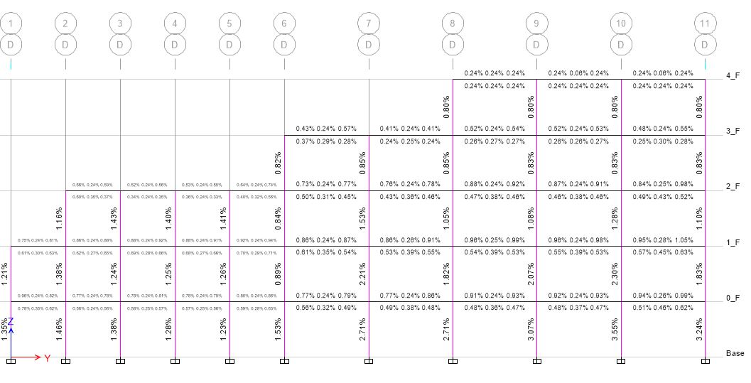

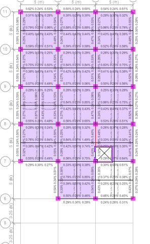

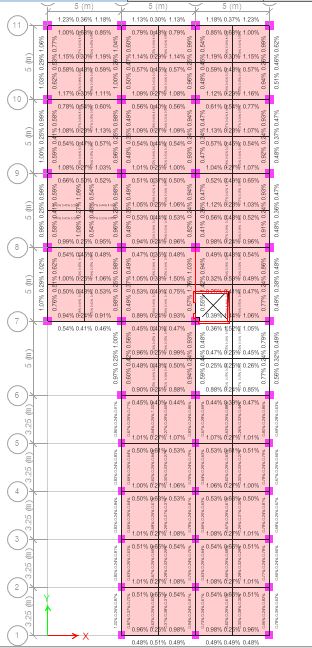

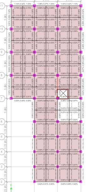

@EngrUzair thank you sir. For your reply. Sir kindly please refer me some document that I need to understand Modal Mass Participation Ratio table better in ETABS. I got below attached output. What might be complications. Also below outputs are appropriate??? As you can see beams near lift failed and one at the corner also failed.
