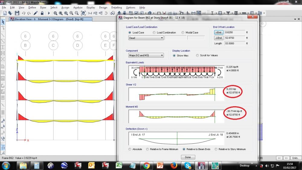

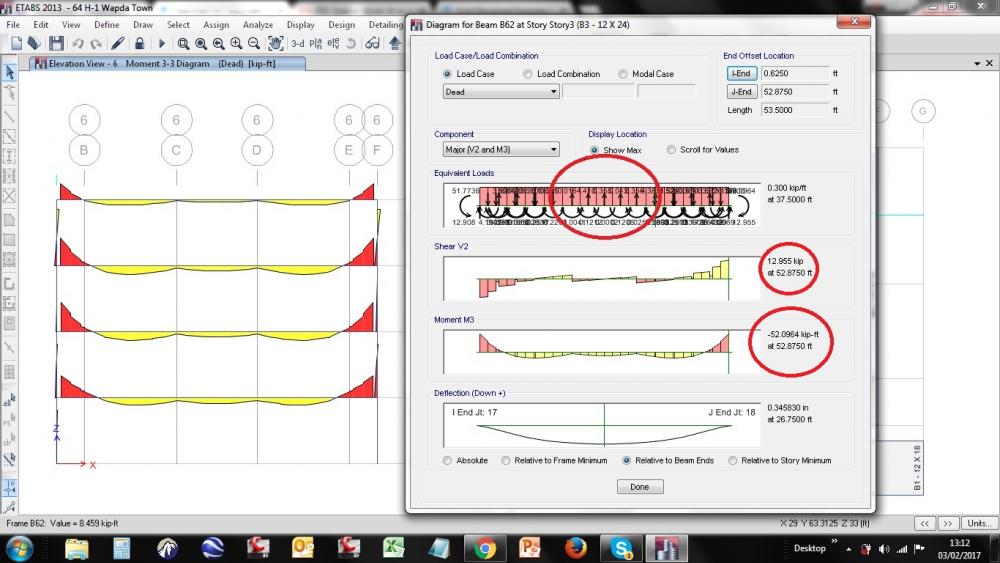

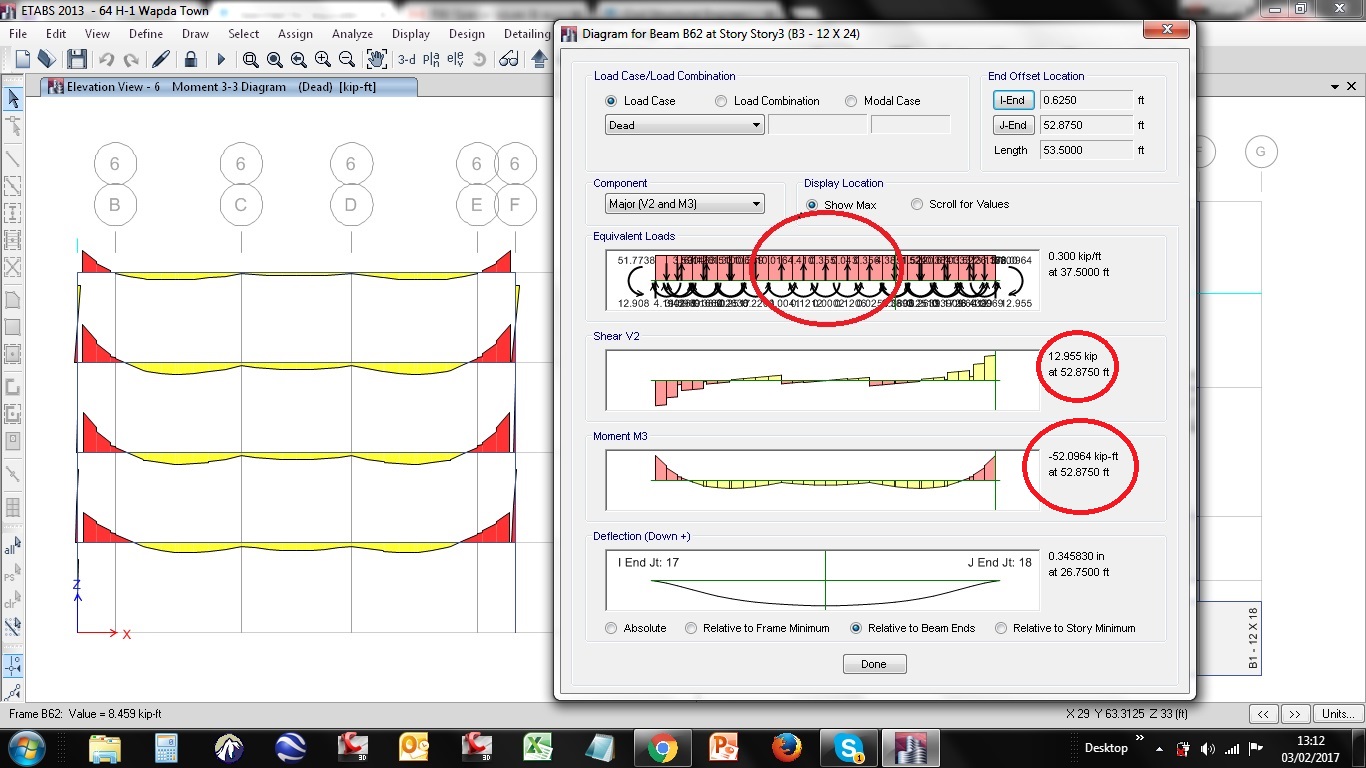

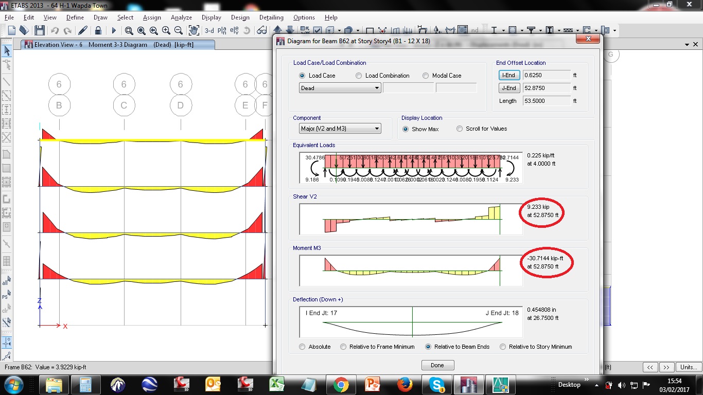

Attached are two screenshots of the analysis of a continuous beam. One represents drop of loads from slabs with incorrect meshing(Auto meshing) and the other represents with correct meshing(manual meshing). Apparently, there is a big difference in the analysis results of the two mentioned by the circles. I posted it here to get further elaborations from the members to understand ETABS in a better way. Hope we can dig it more.

Rana, I am referring to the slab meshing. You had it right that I have meshed a shell onto the beam. However, the beam supports two shell objects. But the meshing lines of both the shell objects did not coincide at the same point in the second case due to irregularity shape of one shell object from another. Afterwards, I manually drew some null lines to such that the meshing lines of both the slabs fall on the same points on the beams and had the analysis. I noticed a great deal of a difference in moments for both situations keeping every other thing same(as mentioned). How do you see what I have done? Any suggestions I could do it better?
from your screen shots, i extracted, auto mesh in your first case is telling opening in slab plan in mid where it showing upward lifting from slab, slab thickness is more than usual (a screen shot of ur framing will clearify my doubt)
in ur manual meshing the same result at mid beam is showing but the at beam end ways it is showing the manual meshing of th two slab is very close as it is showing up and down loading from slab, (make the nodes of two slab concide it will work )
