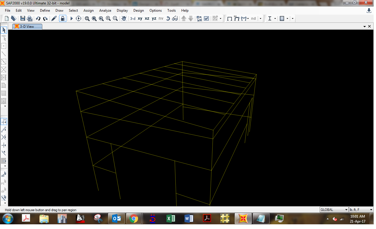

I have a model from a client to review. There are these horizontal members that are having the P-M Ratio value as greater than 1. Showing that the members are over stressed. Now the client asked me to ignore it, as these elements will be braced by the sag-rods but that they cant be modeled on SAP2000. Is it true that we can't model sag-rods on SAP? If yes, then how can I check that whether these sag-rods will reduce the P-M Ratio of these elements to 1 or not?

Can you please explain the image. What view is this.. looks like a elevation but what are we looking at?
You can model sag rods but arrangement is key to understand if they are acting as discrete bracing or not. Read my reply below.
The horizontal members are the ones which will be braced using sag rods. yes its elevation view. We have similar horizontal member at the other side too and the 2 are to be braced using sag rods. Design of sag rods will be similar to that of cables, not sure if SAP2000 can design it accurately or at all, never did it. Or do u have anything on design of rods or cables in SAP2000?
You can model sag rod as bracing (Sag rod properties can be defined in a frame section and modelled as a brace) provided your design condition allows the sag rod to behave like a brace as I mentioned in the previous post. Once you model them, see the forces and design accordingly.
