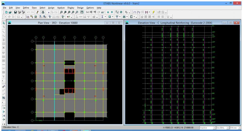

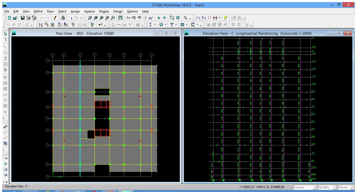

My question is  i have  designend a mixed use building using Etabs version 9.6 the reinforcement results have seen exactly with out any overstress and axial compressive ratio warning, but when i was checked it on Etabs 2015 almost all the columns and beams becam over stressed and compressive ratio exceed warning measseg, pleace can you help me why and what new design consideration was added in the latest Etabs.

But I need more explaination about that exaggerated difference on output result and which design parameters and limiting ratios create that difference.pleace help me I am highly confuised so I was restricted to use Etabs 2015 because it asked me large column and beam section relative to lower version. In short why Etabs 2015 limit the compressive ratio(Ned/Ac*Fcd..) to around 55 percent (in my opinion this creat all that difference), if this is the case, how can i able to edit that ratio limit, if i am wrong what is the case.?????
Thankyou for your serious consideration in advance!
First, be sure of the units. Second, there is no difference between two. ETABS 13 and onwards, they increased the non linear capabilities so it 'wont effect most of the users' as they say in their manuals. You can refer to release notes to find the new enhancements/changes.
Also make sure, the design code, reduction factors and load combinations you are using in newer version are right.
After I have designed using Etabs v9.6 I only opend on Etabs v2015 with out any change made and then I have choose the design code which similar to the previous one and also the combination is similar.but still overstress warning have seen.
