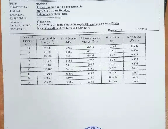

Is there any Elongation % limit for different bar size specified on any code (specially on eruo code ) and what will be you comment about elongation result of this under posted test result??

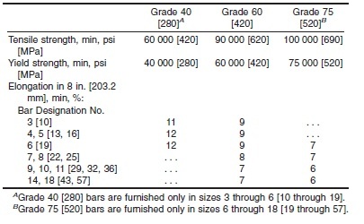

Elongation Limits are given in the material specifications applicable to the reinforcing bars under consideration.
 For example, in case of American Codes, these limits are available in relevant ASTM standards (e.g., ASTM A706, ASTM A615 etc.), depending upon which of these specifications correspond the rebars being used.
In case of eurocodes, elongation limits should be available in respective eurocode or British Standard (BS 4449 etc), as applicable.
Thankyou EngUzair for your continious support! If you have the standards pleace help me.
