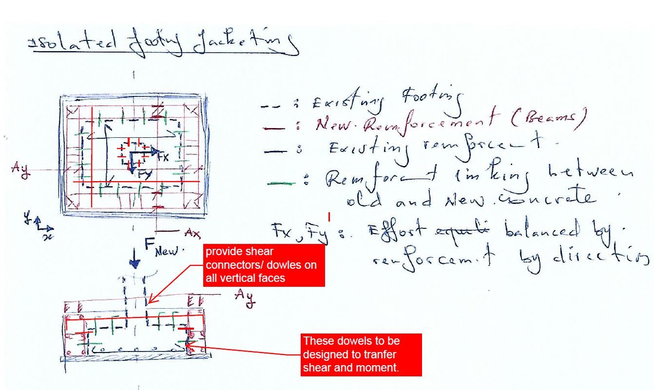

Due to a additional load on an existing isolated footing, I’m trying to widen and reinforce it by using the jacketing technic, using two orthogonal beams as per the attachement
My question is about new beams reinforcement  :
1.Is longitudinal beams reinforcement , by direction , should balance all the new effort from the column , regardless existing reinforcement in the existing footing ?
2. What are disposition for calculating links between old and new concrete?
Thanks a LOT.

Hi Faisal,
Please see my comments on your sketch below. I would suggest to add more shear reinforcement (at least 2 layers, one looks flimsy) between existing foundation and the jacket. Obviously, it would be based on your calculations to transfer punching shear, one way shear and moment. Also, I would suggest to add shear connectors/ dowels/ nelson studs to all vertical faces of the foundation and provide continuous reinforcement as shown connecting periphery jacket beams and new pour. Also, if you are excavating around existing foundations, please give some thought to that so that the excavation doesn't undermine adjacent foundation.
You need to check that. Consider the new foundation footprint, calculate bearing pressures, check moment at critical sections and see if that still works based on new column load and new foundation area. Similarly, you need to calculate shear and moment the the joint of jacket and existing foundation and make sure there are enough dowels to transfer that across.

I agree with Umar. Normally the strength imparted by dowels exceed the requirement. So I would recommend simple checks only. Don't go for detail calculations. Dowels #6@ 9 inch center to center would work in all normal cases. Dowel bars are not expensive. The costly item is the grout that is injected in the drilled hole. Considering your structure, overall cost for dowels would not be significant.
