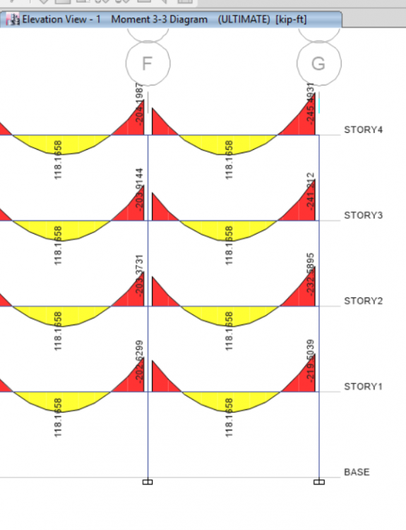

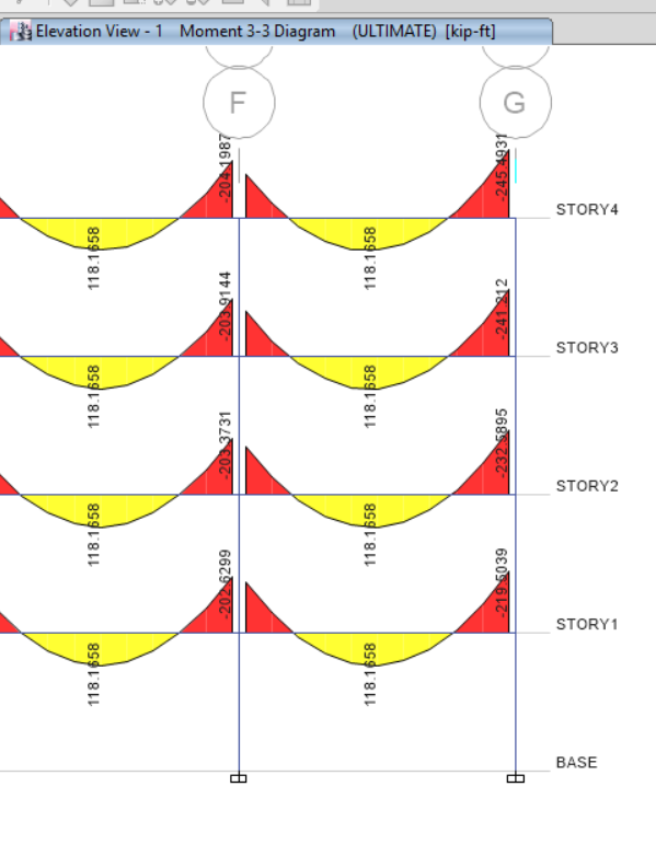

I have analyzed a Beam Column Frame.
All beam(9"x 24") and column(12"12) are in section.
All columns are 20' spaced from each other.
I imposed Super Dead Load 2.15 k/lf
Live Load 2.65 k/lf
In Moment 3-3,
For typical load combination ( like 1.2 DL+1.6 LL)
why positive bending moment changes due to its story height (marked in red circle) though all story beams are equally loaded.
Can anyone tell me the reason?
 Thanks in advance.

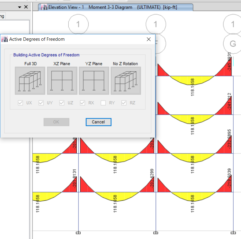

But i don't know the meaning of Building Degree of freedom.
what does it mean Ux,Uy,Uz.
why i use( tick) click on every box except Ry in continuous beam analysis?
thanks in advance

Dear Shamim,
Degree of freedom concept is basic of structural analysis, it is hard to explain for me. There are three translations and three rotations, translations are UX, UY, and UZ and rotations RX, RY, RZ. Check the following links for further understanding.
http://docs.csiamerica.com/help-files/etabs/Menus/Analyze/Set_Analysis_Options/Set_Active_Degrees_of_Freedom.htm
http://docs.csiamerica.com/manuals/etabs/Analysis Reference.pdf
Regards
On ‎2018‎-‎02‎-‎10 at 4:26 AM, waqar saleem said:
Degree of freedom
Degree of freedom = direction in which an object can move. There are 3 Horizontal Directions and 3 Rotation Directions to say the least.
Thanks Ayesha,
I want to know why i need to active Ux, Uy, Uz, Rx, & Rz. Why not Ry for 2D Frame analysis in XZ plane?
above this condition @waqar saleem solved my problem.
I also want to know which degree of freedom should i keep active for 2D Frame analysis in YZ plane.
