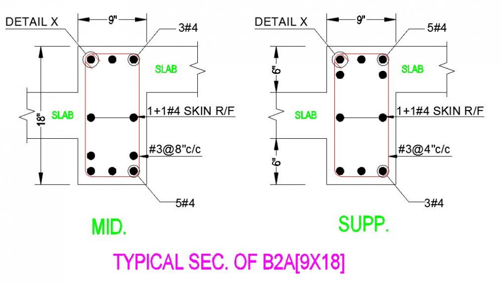

I need to know that how to model a beam in etabs, when slab on both sides of it is at different levels? for reference section of Beam is attached. Second question is, in this case do we need some special detailing if yes then what is it.

Generally, offsets for beams and slabs are ignored in ETABS to keep modelling simple and error free. Such cases can be analysed manually. Analysis also depends on reinforcement and detailing for slabs. For example, if you don't provide any negative reinforcement in the bottom (mid-height) slab, you won't be transferring any moment in the beam as the top of slab would crack.
On 3/6/2018 at 3:31 AM, Ayesha said:
You can see this post for reinforcement detailing. Just don't provide the top reinforcement in the bottom slab, rest all everything shown there is applicable.
Thanks ayesha your response is really helpful. one last thing " what is the effect of top reinforcement of bottom slab if i provide that"?
I will reply to that but I want to know what do you think what would happen?
