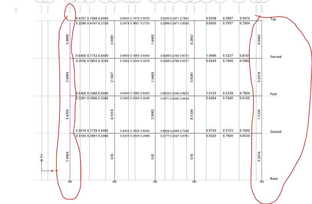

I analyzed a two story residential concrete building in ETABS 9.7
After designing the structure ETABS shows more Longitudinal Reinforcement in upper story.
is it right??
In my concept, bottom story longitudinal reinforcement should be large.
I modeled the structure as pin support at base and there is no seismic and wind load applied.
Column axial load and longitudinal reinforcement snap shoot are attached below.
Help me Please.
Thanks in advance.

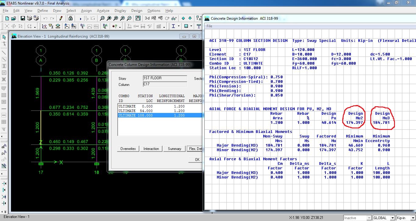

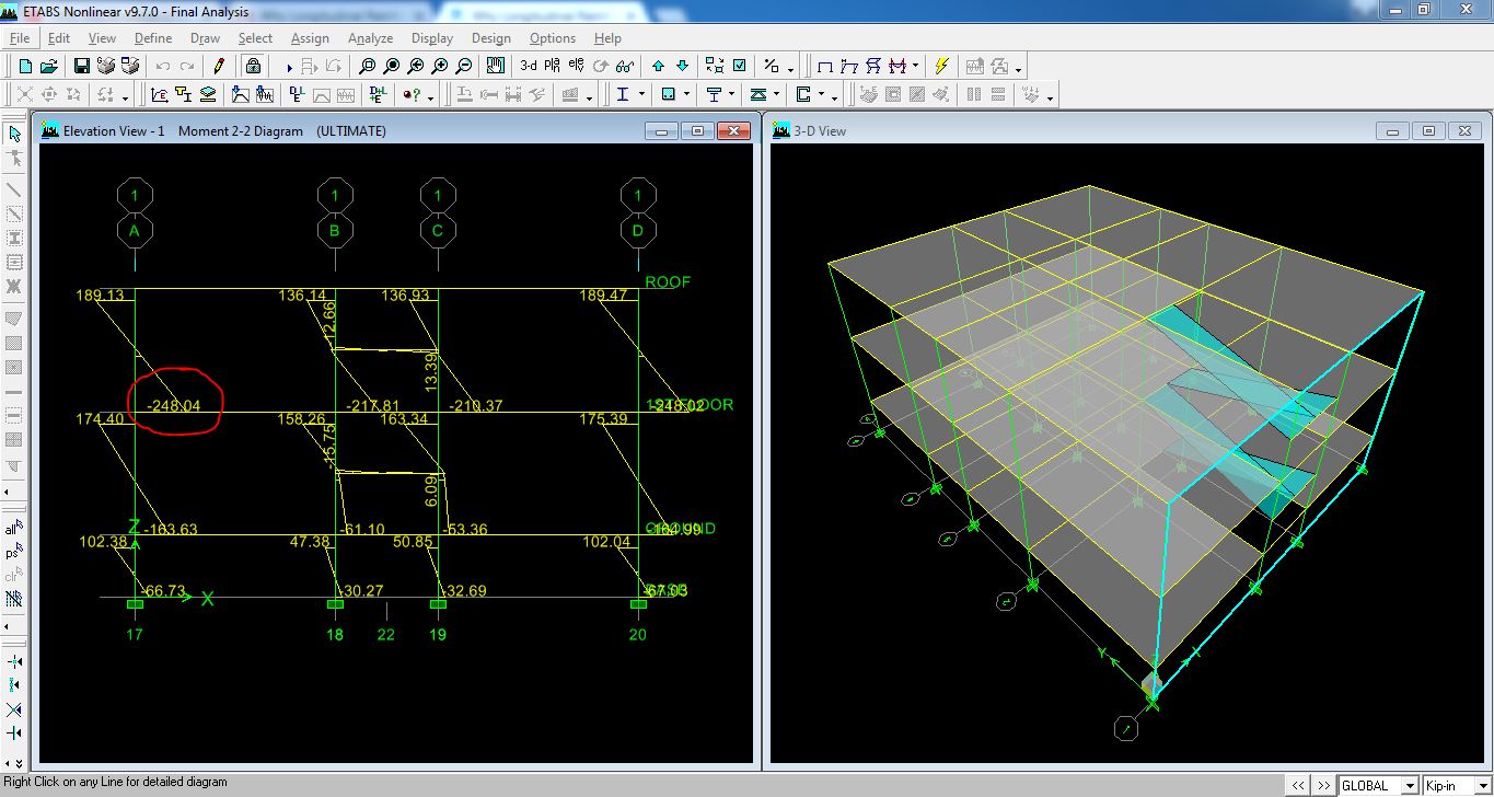

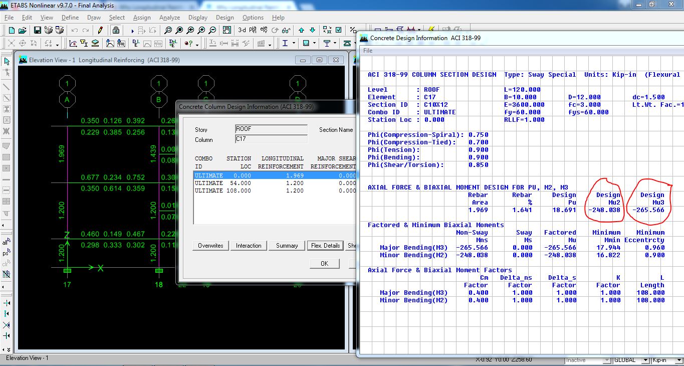

I got the point, why Longitudinal reinforcement increasing, Due to M2-2 & M-33 is greater in Upper story than Lower.
But another question arrived in my mind why upper story M2-2 @ M3-3 is larger than bottom? File Attached.
though I assigned less load in Upper story than Bottom story beam and slab.
No Wind & earthquake load applied.
Please Explain me.
It is not only the difference of moments, the difference of axial load is also responsible for increased demand. The lower axial load, coupled with increased moments is the reason.
In top story, the unbalanced moment is distributed among three members. In lower stories, four members share the unbalanced moment at the beam-column joint.
It's helpful answer.
According to your comment in concrete frame structure, column unbalanced moments  will be always greater than it's immediate lower story column moment?
because top story will always three members.

Guys take a look at the interaction curve of columns. The curve where every point gives the value of moment and axial load for which the column will yield. When the axial compression reduces the moment capacity will also reduce. So, you need more reinforcement to meet the demand.
