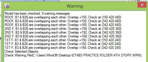

Hello Friend ,
Im fresh user of Etab , appeared this kind of issue after check Model .
kindly guide me .thankx
Warnings are clear in details (i.e. type of warning & their locations).
You need to correct the problems mentioned in the warnings, through merging or deleting/redrawing the members or elements, one by one.
In the essence, there should be no warning message, on using Check Model command. Otherwise, the structure would not be correctly modelled.
