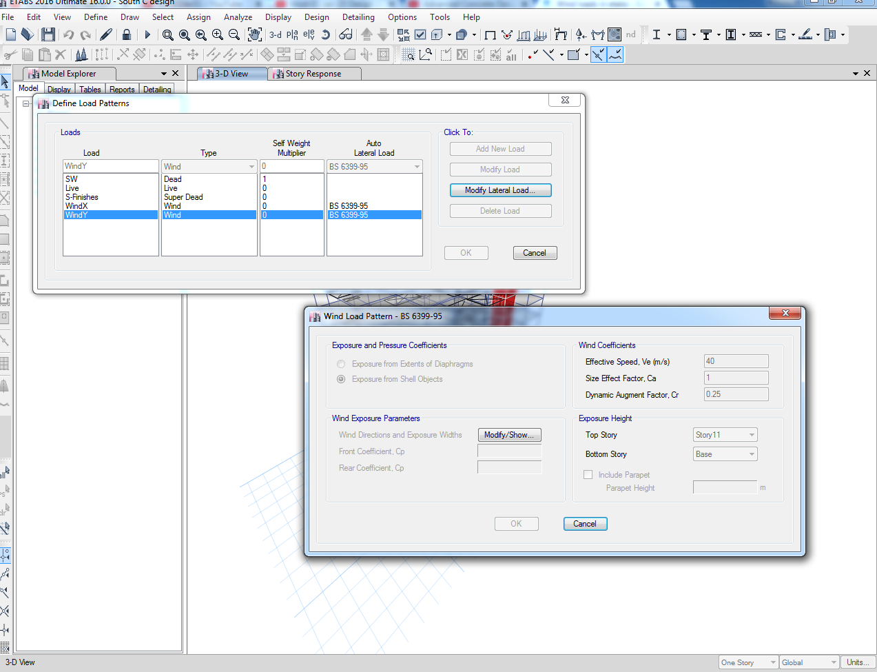

I analysed two different structures and discovered that etabs gave the wind loads as constant lateral loads at the top of each floor (except for the top floor which was lower for some reason). I expected the loads to increase as one went up floor by floor not be a constant value. Is this result standard for others using different codes? I use BS 6399 and I tried both the rigid diaphragm option and the 'load on null shells' option. Any illumination would be greatly appreciated.
It should increase as you go up (if you have same storey heights).
Referring to your load pattern definition, you should select the exposure from diaphragms (assign diaphragms to slab also). and also do define wind exposure parameters.
i am not familiar with this British code but in  american codes there are different case for wind exposure parameters, so there we have to add that much number of wind patterns separately.
