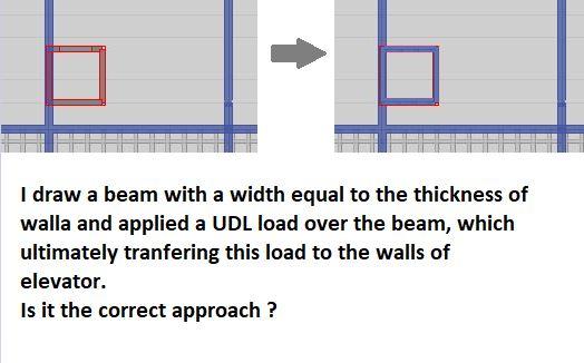

How will I apply the UDL over the walls of the Elevator? There are three options in assigning a load to a building component as shown in the attached picture i.e Shell, Frame, and Point load, then how will I apply the load over the walls?
I have an idea for applying UDL over walls. If I draw the beams over the top of the wall and apply the UDL load over the beams as shown in the attached picture. Is it the right approach? or I should find another way?

On 1/7/2019 at 1:17 PM, Engr. Salman said:
Dear Major!
The top of shaft will be having a slab and why not applying area load on it ???
