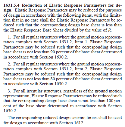

I used Response Spectrum Analysis (CQC) for analyzing Base+6 Floors of residential building.
The building structure is consist of special resisting moment frames and shear walls.
In base share re scaling as per ASCE the scale for X direction can be changed to 85 percent but in Y direction after re scaling it is going be to more than 100% like 124%.
What is the problem and how can I solve it?
