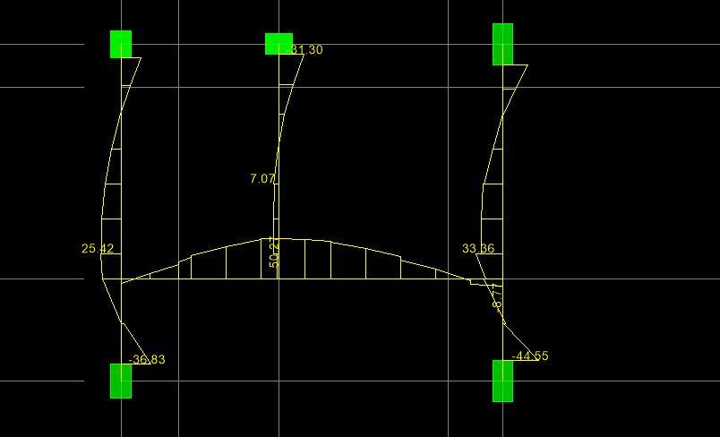

Dear Fellow Engineers,
Could you please check the attached pics of my model and guide me, whether to divide the main beam at the location of secondary beam Connections. In my model the secondary beam is inducing some negative moment in the main beam and to counter this, do we need to release the moment in the main beam. If yes Than what percentage and How to provide the detailing for site to make beam behave same in real world scenario.
Also I am attaching the model. Could any callegue please check it and let me know any Modelling Issues.

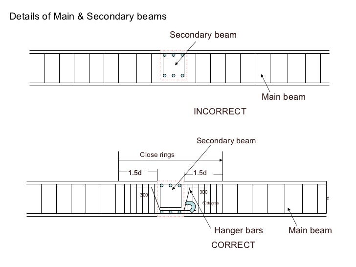

You can release all the moment and let secondary beam behave as pinned end. For reinforcement detailing, use hanger bars.
reinforcement-detailing-18-728.jpg?cb=13

What is the criteria for providing hanger bars? any code reference etc.?
Requirement for hanger bars and stirrups can be checked through strut and tie . Here is an excerpt from Design of Concrete Structures" by Arthur Nilson, David Darwin Charles Dolan (and illustration attached) on the same topic providing additional info :
  Quote
"Commonly in concrete construction, secondary floor beams are supported by primary girders, as shown in Fig. 11.13a and b. It is often assumed that the reaction from the floor beam is more or less uniformly distributed through the depth of the interface between beam and girder. This incorrect assumption is perhaps encouraged by the ACI code "Vc+Vs) approach to shear design, which makes use of a nominal average shear stress in the concrete, vc=Vc/Bw d, suggesting a uniform distribution of shear stress through the beam web.
The actual behavior of a diagonally cracked beam, as indicated by tests, is quite different, and the flow of forces can be represented in somewhat simplified form by the truss model of the beam shown in Fig. 11.13c (Ref. 11.7). The main reaction is delivered from beam to girder by a diagonal compression strut mn, which applies its thrust near the bottom of the carrying girder. Failure to provide for this thrust may result in splitting off the concrete at the bottom of the girder followed by collapse of the beam.
Proper detailing of steel in the region of such a joint requires the use of well-anchored "hanger" stirrups in the girder, as shown in Fig 11.13 a and b, to provide for the downward thrust of the compression strut at the end of the beam (Refs. 11.8 and 11.9). These stirrups serve as tension ties to transmit the reaction of the beam to the compression zone of the girder, where it can be equilibrated by diagonal compression struts in the girder. The hanger stirrups, which are required in addition to the normal girder stirrups required for shear, can be designed based on equilibrating part or all of the reaction from the beam, with the hanger stirrups assumed to be stressed to their yield stress fy at the factored load stage".
