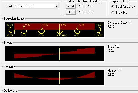

Well I do Know that, Etabs Checks all the members for there minimum area of Reinforcement as per code. But I came across one design of mine where I see for a beam size of 228.6 mm wide and 304.8 mm deep. Etabs gives Bottom reinforcement less than what I calculated manually. I am attaching a few pics for the problem. I request to please put some light on this. The beam is designed for M20 and Fe 415 steel.

Etabs only gives you minimum area of reinforcement incase of slabs and columns provided that the designed reinforcement is less than the minimum area of reinforcement as per design code. However as far as design of beams are concerned, you must always calculate the area of steel manually and check it with the designed reinforcement by etabs. Etabs always give the designed reinforcement for beams whether its less or more than the minimum area of steel.
ETABS does give correct values of reo (it does take into account the lower/upper limits of reo for a particular code).

Please check what code says when you provide As = 1.33 x Asreq ???
And why ETABS giving less moment and reinforcement than what you getting manually is totally a different question and depends if you are modelling it right or if you are manually calculating it right.
