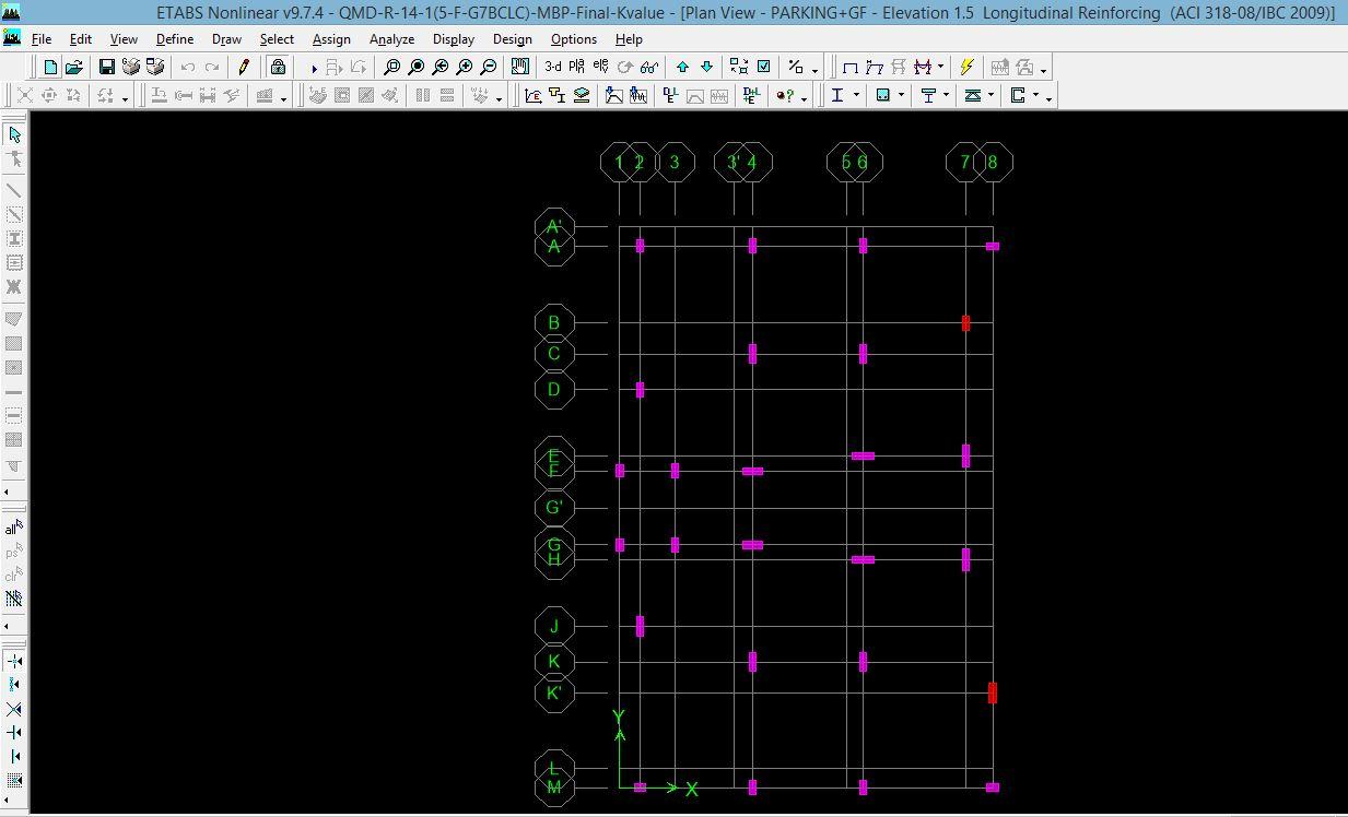

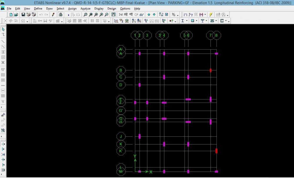

@SMAQ, Sorry for getting late but I have checked and studied your model, analysis done by etabs seems reasonable to me but the design is somehow not acceptable. Etabs is considering the 'k' value for those columns almost near 3. I suggest you to design those columns in some other program or manually.
P.S: When I change the 'k' value to 1 in etabs, the columns passed with 6T16 bars.

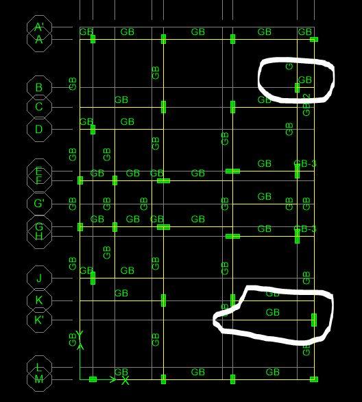

Now I am thinking to connect it with plinth beam as the pattern in attached pic as I am not getting any Idea, and frankly I don't have idea to calculate the "k" value as per ACI-318.
Also You mentioned the model is showing "k" calue > 3, But the model I see the "k" Value as "1" only. I dont know some thing is wrong.
