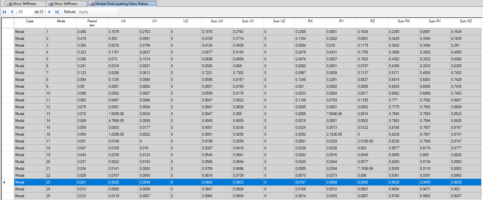

I am a master research student. Actually, I am working on the assessment of the dynamic behavior of the non structural components on the modal properties of the building. I am trying to determine the stiffness matrix from mode shape. Is it possible to determine the K matrix? From the MPMR table, I realized that there is a higher mode effect (to reach the 90%). What is the best method to determine the stiffness matrix?

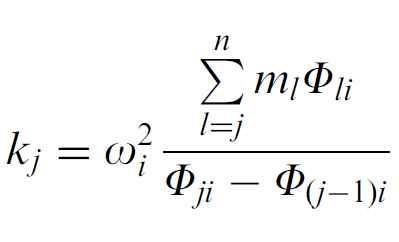

Usually, this is the typical method. But, i have ambient vibration measurements for the building, these measurements give the mode shape, so i need to use them to determine the stiffness matrix ( i have also the mass matrix M). The aim of my research is to model a 3D building and simplify it to a 2D model and compare the results.

for a particular mode: mass matrix x acceleration matrix + stiffness matrix x displacement matrix = 0
You can get mass, acceleration and displacement data for a particular mode and then work out stiffness matrix.
