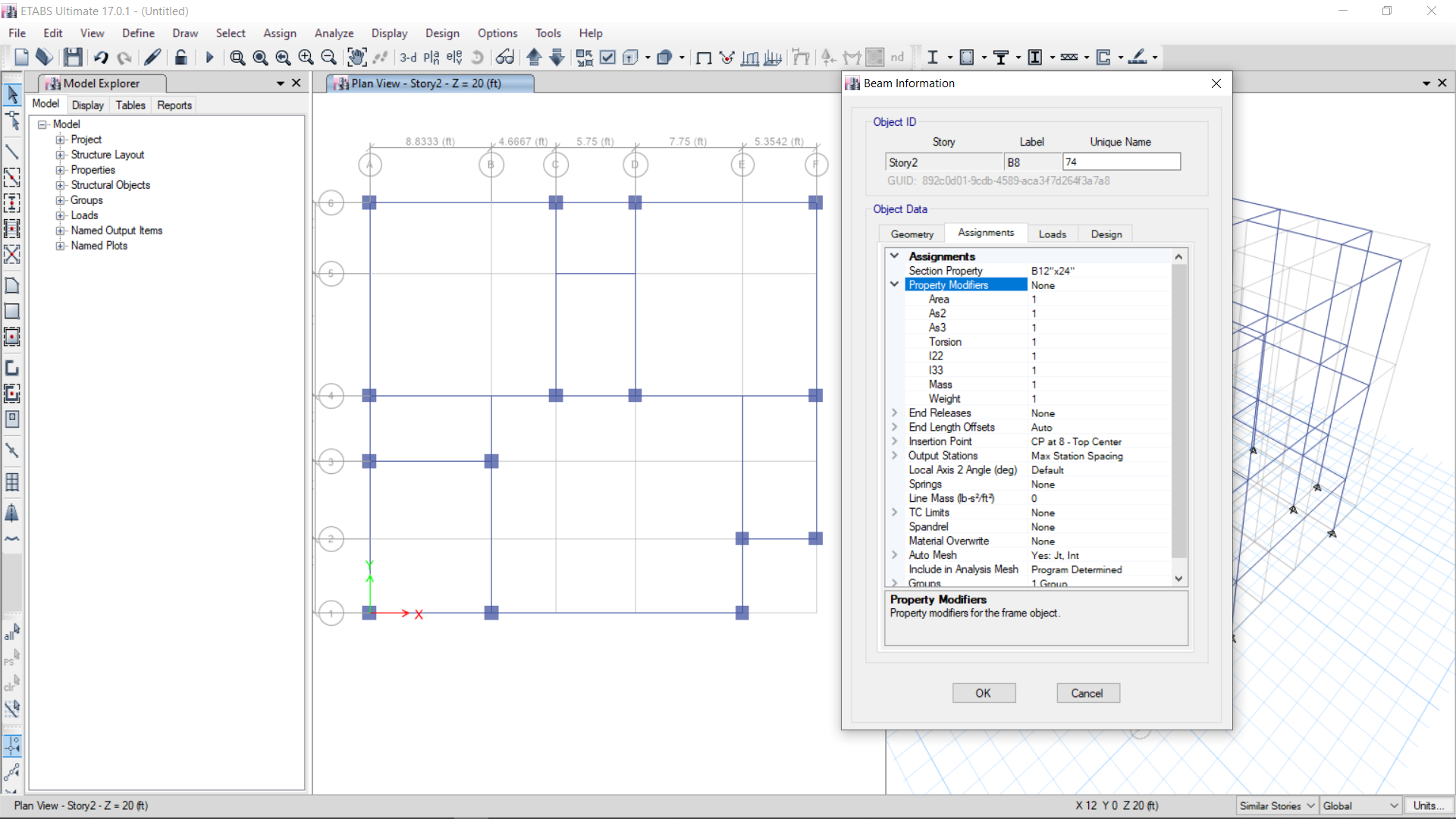

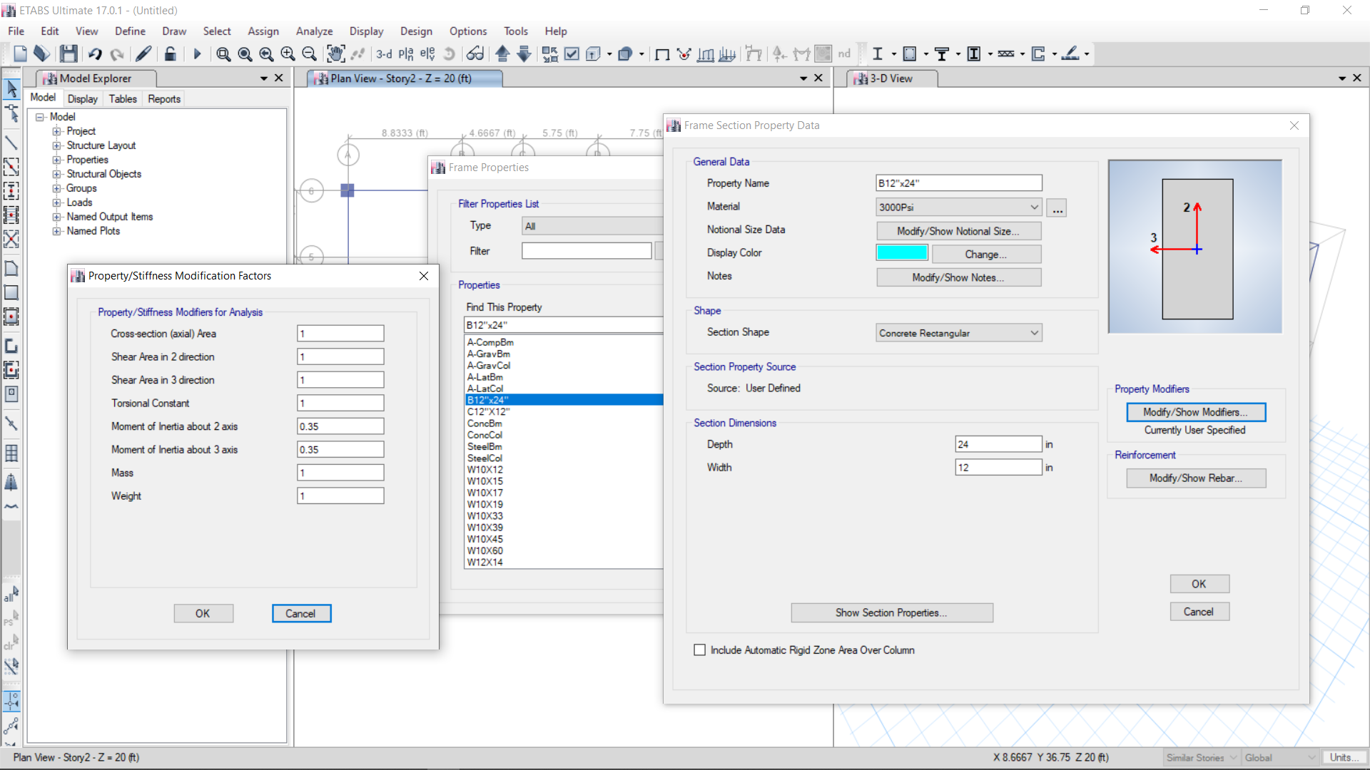

I am facing an issue in ETABS. I have defined the sections with property modifiers and modeled the beam/columns of those sections. But when, in model screen, I right click the structural component (beam,column) and see the property modifiers , they are not actually assigned.  I am not sure whether ETABS will take them into account or not in analysis. I have attached screenshots.

In ETABS, you can modify geometric properties of section either from within "Frame section property data" window, or by going trough this route: Assign > frame > property modifier.
You have used the first option. When you do that, the information will not appear in "beam information" window. But you still got your property modifiers, which you can see when you go to the "Frame section property data" window.
