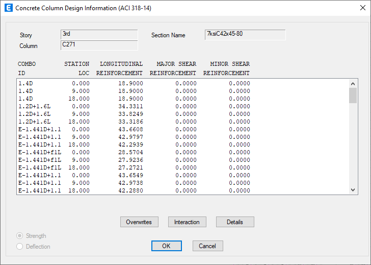

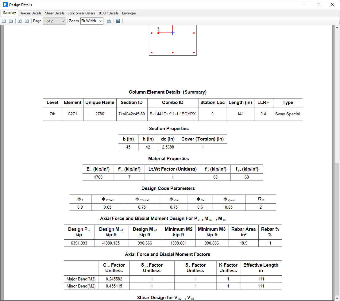

Hi Everyone,
I have defined various load combinations such as 1.4D, 1.54D-1.1E, 0.77D-1.1E, 1.54D+0.55L+1.1E etc. for the analysis & design of RC structure. However, when I display design information for beam and column longitudinal and shear reinforcement, the program etabs and SAP do the design and display the reinforcement but they do not show the load combination on which the design is displayed. How the program does the design? Does the program automatically design beam and column based on taking maximum values from the defined different combination or take envelope? Shell area elements are clear as we can view the results for our various defined combos.
