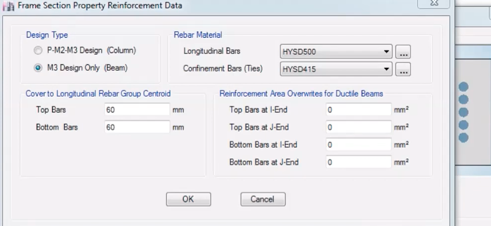

Rifat,
I think you can define it in Frame Section Property Reinforcement Data. If your question is about cases where reinforcement is not defined, I don't have the answer on hand as I am out of ETABS for 10+ years now.
4 hours ago, UmarMakhzumi said:
Rifat,
Thank you Umar for your reply. In this box have a look "cover to longitudinal rebar group centroid" having two options top bars and bottom bars. How if I want to define clear cover from side face of beam (not from top and bottom) then how can I do in ETABS?
