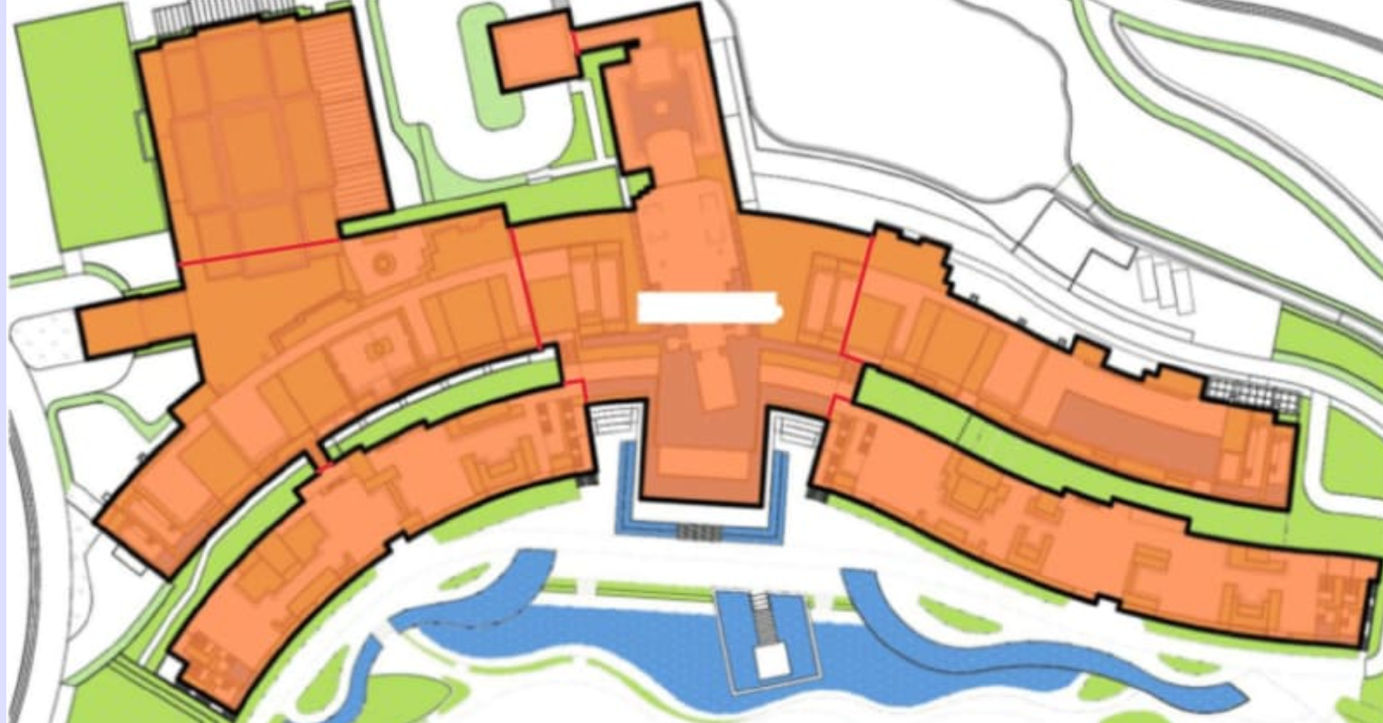

Thanks for the response... I do not have release to provide the plan.  The building consists of three or four smaller structures (still regular sized buildings) and the 'footprint' of the structure is extremely irregular. The smaller sized structures are of different heights (multi storey).  It is a hotel complex in Vietnam.  Construction is reinforced concrete slab with drop panels, and in my opinion, needs real construction joints.
The engineer that was looking into the design was intending on using expansion joints predicated on maximum distance recommended by ACI. In reality the building should have joints at the interface of the various buildings. He was looking at a couple of joints as opposed to maybe 8 or 10.  I was wondering if somenone had a reference to joints based on building envelope issues.
Again, thanks...
I don't know if this will post... the sketch is public domain... The red lines are joints that I've suggested. Due to the difference in elevation of the varioius components, there could be others.

The building is really irregular. I would suggest isolating different sections of building if it is possible considering building envelope and architectural plans. For concrete buildings, the normal rule of thumb that I have seen out of handbooks in 180 feet. You can also refer to ACI 224.3R to further details.
Hope that helps.
Thanks... the building is extremely irregular... I don't think you can travel  150' without 'hitting' an irregularity. I was trying to find a source for control joints based on the irregular building envelope.

pour strips can be effectively used to mitigate column and wall creep and shrinkage, restraint of creep and shrinkage in long floors or roof systems, creep caused by prestress forces and volume changes caused by variation in temperature. It works in irregular plans as well. Moreover at the moment you have one irregular shaped foot print, by providing expansion joints as marked in red on above posted plan, you'll be facing at least two irregular foot prints.
Pour strips work OK, but generally not when you have a transition in structures.  The plan is a compilation of several structures. You want a real joint at those junctures.
